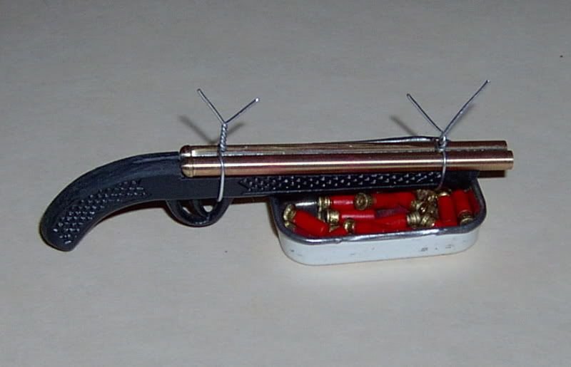

I searched & searched, then I searched some more, then after I was unable to find a 1/6th scale double barrel shotgun I broke down & made one. 21st made one I really liked but I was unable to lay my paws on one of them.

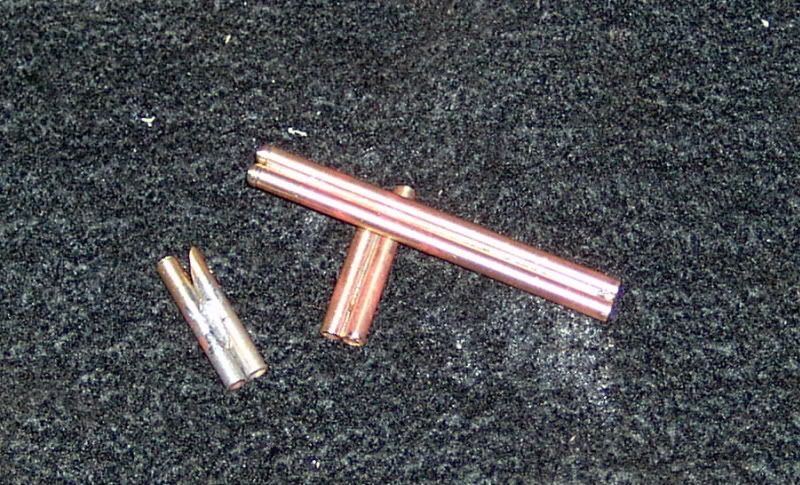

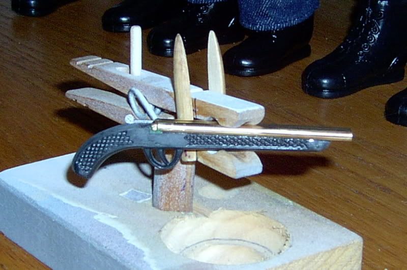

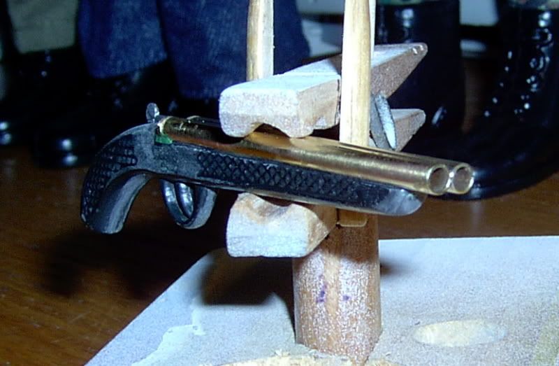

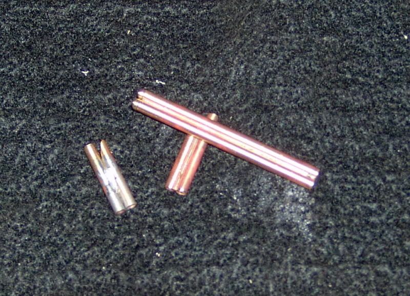

First I started by making the barrels from 1/8 dia. brass tubing, filled in one end with small round head brass screws & solder. Then I machined them round & matched, last I soldered the two barrels together.

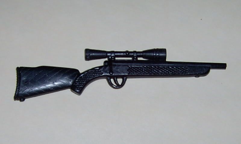

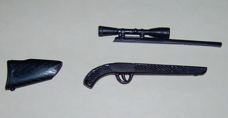

Second I hacked out the stock from a broken AT rifle that I have had kicking around for years. Dont cringe folks all worked out great.

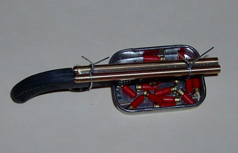

Third I attached the barrels to the stock with two part epoxy. Note the shotgun shells are made from 3/32" dia. plastic rod.
Forth I added the butterfly catch, made from ultra fine solder, for detail.

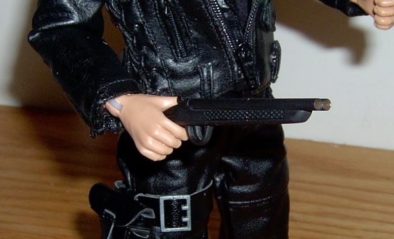

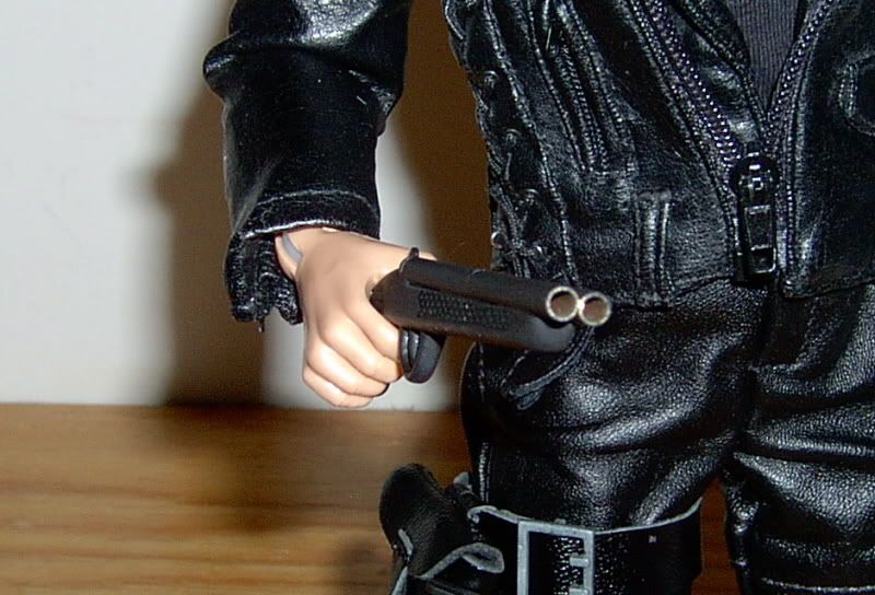

Fifth & last I shot the whole thing with flat black.
Please let me know what you think, good or bad I am grateful for all comments from you guys.
